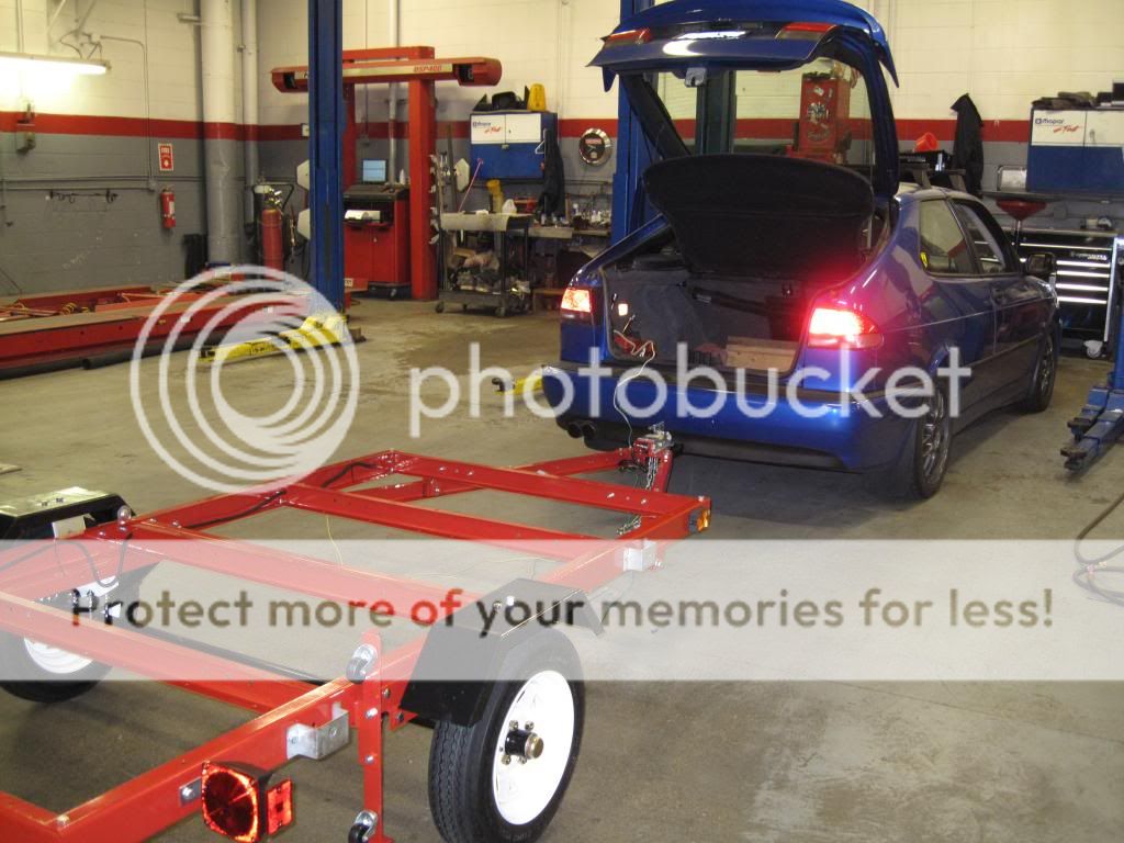

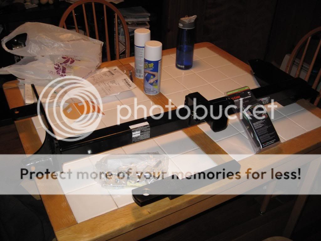

As you may know, my wife recently gave in to my incessant pleading and let me buy a trailer. Owning a project house means either a truck or a trailer is really a good thing to have. Since my friend's nearly 20-year-old truck just passed away, it was time to make the purchase.

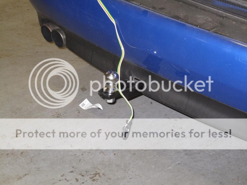

I ordered a hitch and wiring from Amazon. The hitch also came with a drawbar and pin. Because my car monitors the lighting circuits for blown bulbs, there is no amperage to spare for a trailer. That said, I had to buy a powered trailer light converter which monitors the lights to see whats on and then uses battery power to light the trailer. My converter is currently run directly off the battery so there is a constant draw even with the car off. I need to put a switch in the trunk to avoid killing the car.

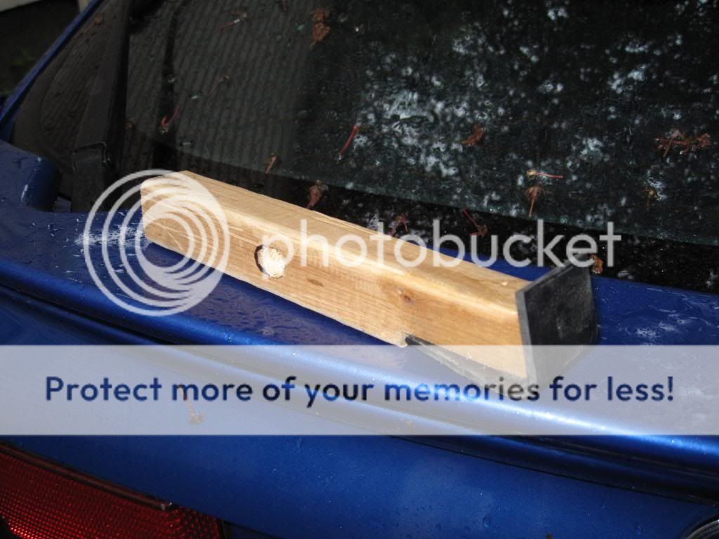

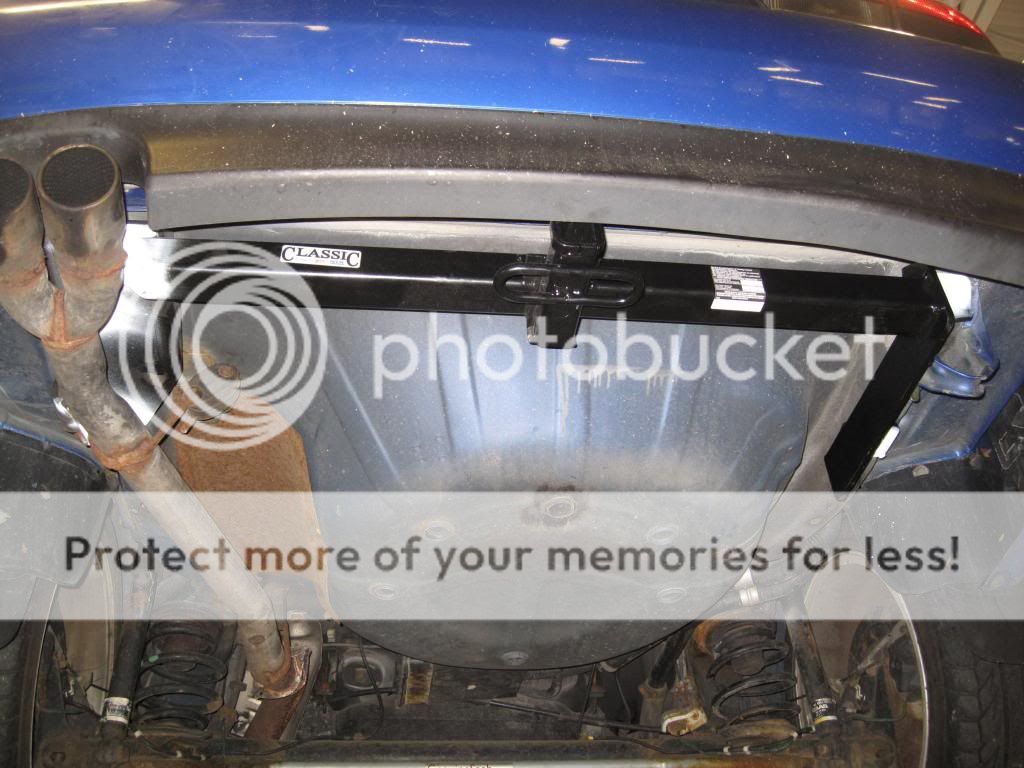

Between the different exhaust placement on a Viggen versus a regular 9-3 and my custom exhaust, I needed to chop a bit of the corner off the hitch for clearance. This really shouldnt impact my towing capacity because the trailer itself was already the weakest link. I sprayed the bolts and cut parts of the hitch to try to minimize rust.

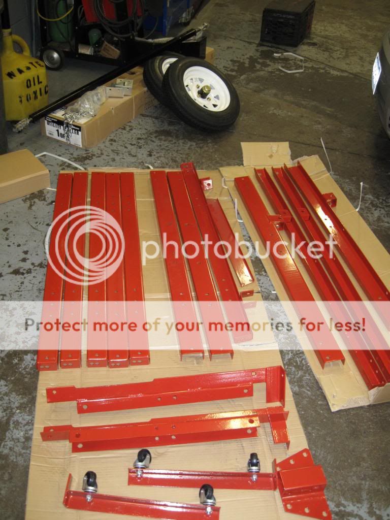

The trailer came in about eight bazillion parts in two boxes that fit conveniently in my trunk. What else would you expect from a Harbor Freight kit?
First you assemble the shit out of it.

Test fit and bulb check. Aside from the aforementioned switch I want to put in my trunk, I also plan to run the hitch wiring through the car and out the bottom rather than having to close it in my hatch. Its more professional I think.

I did unfortunately have to cut the bumper because Viggens have lower bumpers than base 9-3s.
However, I did save the piece I cut out and crafted a plug that fits into the receiver so the whole isnt obvious unless you know its there.
At this point Ive only made one light haul. Aside from an abysmal bounce while empty, the trailer is light and easy to maneuver. Very pleased overall.

Per Moofasa, I added a picture of the plug installed to the original trailer thread. Here it is again:
