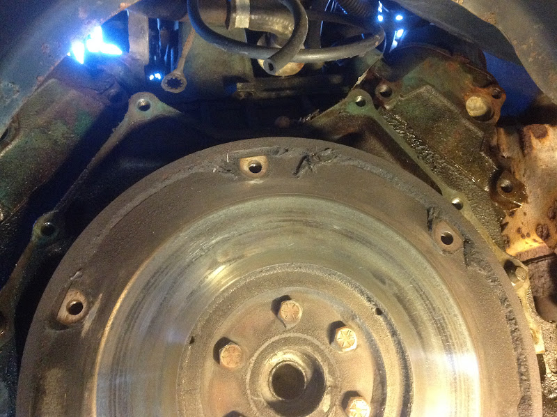

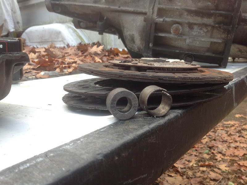

Anyway, got the trans out today. My new transmission jack from Harbor Freight is a significant improvement over crappy jacks but removing was still a little more unpleasant than expected and stabbing is still gonna suck.
I think I found a few causes of slop and chatter and what not...
- Transmission to bellhousing bolts: Two missing, two backed most of the way out. WTF is it with bolts backing out? I torque them properly and then a little more. I'm gonna start using threadlocker on everygoddamnthing.
- Clutch disc: Delaminated! Also some bits of it must have gone missing because I found them around the edge of the flywheel.
- Pilot bushing: Worn away to almost nothing!
Clutch disc and pilot bushing...bottom is delaminated portion (flyhweel side) of clutch disc, middle is the rest of it, top is the disc I'm putting in. Pilot bushings should be obvious.
Also there is a notch in the old pilot because I had to chisel a piece out before the rest would come loose; if you remember, when I put it in it was too tight. I hammered the hell out of it and even left some slight dents in the end of the crankshaft. I think that tightness is what caused its inside diameter to be too small (and then I had to grind it by starting the engine and laying under the car suicidally). This time I'm going to turn it against a grindstone to reduce the outside diameter so it drives in properly and doesn't compress. I made a drill mount using a ratchet extension and some tape so I can spin it. (The design is the same as the clutch alignment tool I made last time and will make again this time.)
Oh, and the center hole in the flywheel was filled with crud, probably a mixture of pilot bushing and clutch.
More of the delaminated clutch:
Remaining thickness is pretty decent for 5 years and 90,000 miles of abuse and crappy engineering/workmanship. (BTW, all the good engineering was stuff that Rope-Pusher told me...and without it the crappy engineering would have dominated.)
Here's that clutch material around the edge of the flywheel:

So let's say your input shaft wore the hole in the pilot bushing bigger-n-bigger.
"Your input shaft wore the hole in the pilot shaft bigger-n-bigger"
Now say the shaft was wobbling around like one of them rear-window hula dancers
"The shaft was wobbling around like one of them rear-window hula dancers"
And the friction surface on the flywheel was recessed
so as the shaft wobbled, the clutch facing was slamming against the edges of the flywheel hole and it cracked the friction material loose where it was riveted to the cushion spring.
and the wobbling was also kicking the 4th gear synchro out of engagement with the input shaft.
So what's gonna be different this time? What went wrong last time that doesn't have to go wrong again? was the input shaft bearing worn so much that it allowed the shaft to wobble right from the git-go? I dunno, but start thinking about what may have caused the failures you see.
Yanno, sum of the input shaft bushings are "Oilites" - bronze particles sintered together with pores that are meant to hold oil. It's a good idea to soak them in oil before you install them, so the pores are full of oil. If it's solid brass, then the oil really won't find any pores to soak into.
"Oilite is formed using powder metallurgy so that tiny pores are present in the metal. The pores are then vacuum impregnated with an oil to improve the materials bearing ability.[3] The material holds approximately 20% oil by volume.[4] The most common lubricant is SAE 30 oil.[5]
Due to the porous structure, machining Oilite poses a special situation. To machine Oilite, the cutting tool must be—and stay—sharp; therefore, tungsten carbide is often used. The sharp tool preserves the open-pore structure, because a dull tool would smear the material and close up the pores that are on the surface adjacent to the journal, which is where the lubrication needs to be. Reaming is not recommended, but can be done with an extremely sharp tool. Honing and grinding should not be performed on any surface that is in contact with the journal as these processes always smear the pores.[3]" - from Wikipedia.

Good thoughts. I didn't realize that machining the bushing like that would close off the pores. That certainly must have contributed. This time I'm hoping to avoid machining the inside diameter.
Also probably contributing:
- Input shaft bearing maladjustment
- Loose/missing transmission-to-bellhousing bolts allowing transmission to wobble
- All year spent with engine mount broken/unbolted (so more wobble)
- Last year, some time spent with transmission mount broken
...and I swear there are a few others that I'm forgetting.
Anyway, I think I'm doing it better this time than I did in 2010, and either way 5 years is good enough for me. If I get another 5 years out of it this time, that means that I didn't get to do the engine swap that I want...
