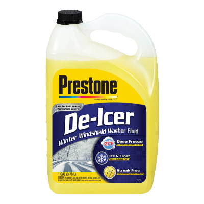

sounds like it may be frozen (at least in the lines or nozzle). did you drive/run the car for long before trying it?? i'd drive around for a while to see if that melts the fluid and, if so, that was the problem.
if freezing is the problem, i'd try replacing the regular washer fluid with something like prestone's de-icer washer fluid which is specialized for winter driving:
i used to run that in my maxima and found it to work better on ice than regular blue washer fluid. it usually doesn't get cold enough here to freeze the regular fluid, but that might be more of a problem out in MI.
alternately, you could try putting in some concentrate or additive to boost the freeze resistence of your fluid:

its not frozen....it started before freezing season. i'm just now getting around to it cuz procrastination. :3
i'd look for a puddle, but i park on dirt/rocks/grass so it would soak into the ground, i assume. i should check levels again, i filled it before....
the other day i used my 'liquid gold' prestone deicer on the windsheild and no scraping required! it was fantastic.
